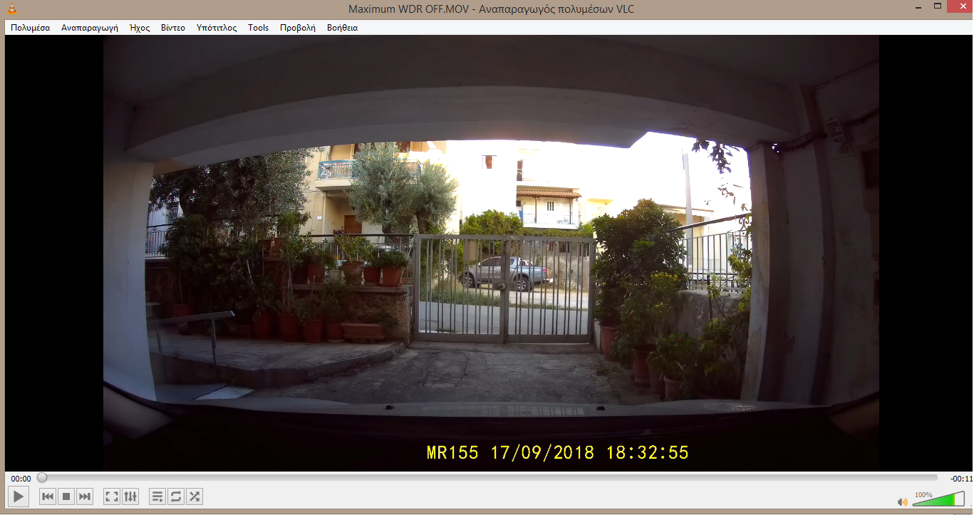

  15. Well i test the new firmware and made all the possible changes to config file.
    I had never tested the 1.7 firmware version so I can not compare it with this.
    As Alsoft said when dissable the WDR the picture is a bit kind of dark at day but at the night without WDR the recording is better i believe.I don't know i am not expert but at day i like the picture better with WDR on...
    We must disable WDR to all resolutions?
    64gb memory card to maximum resolution is for almost 5 hours.To be able to choose the resolution you must use Timacam(i use this for choose only resolution and lerccenker for all the other settings)
    As i said before to Alfsoft's firmware parking guard is disabled.If anyone want to enable it,must to make changes to config file to these:

    Maximum WDR OFF.png maximum WDR ON.png NORMAL MODE WDR OFF.png NORMAL MODE WDR ON.png

  18. Увидите экспозицию в минус -0,3 или -> далее, опытным путём.
    На фото белым заливает дом и он не видим.
    Эту болезнь, таблицы не правят, уже какой день ищу :)

  19. If i remember correct at mod 1.7 wdr must be off only at normal recording.
    To mode 1.8 we must have it off to all recording resolutions?
    It's very handy to have 1080p recording with three different bitrates and choose according your needs.
