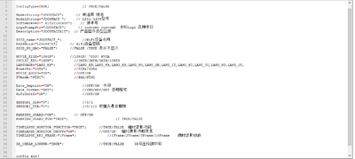

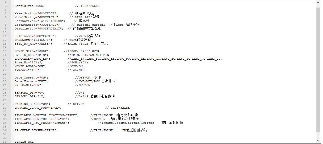

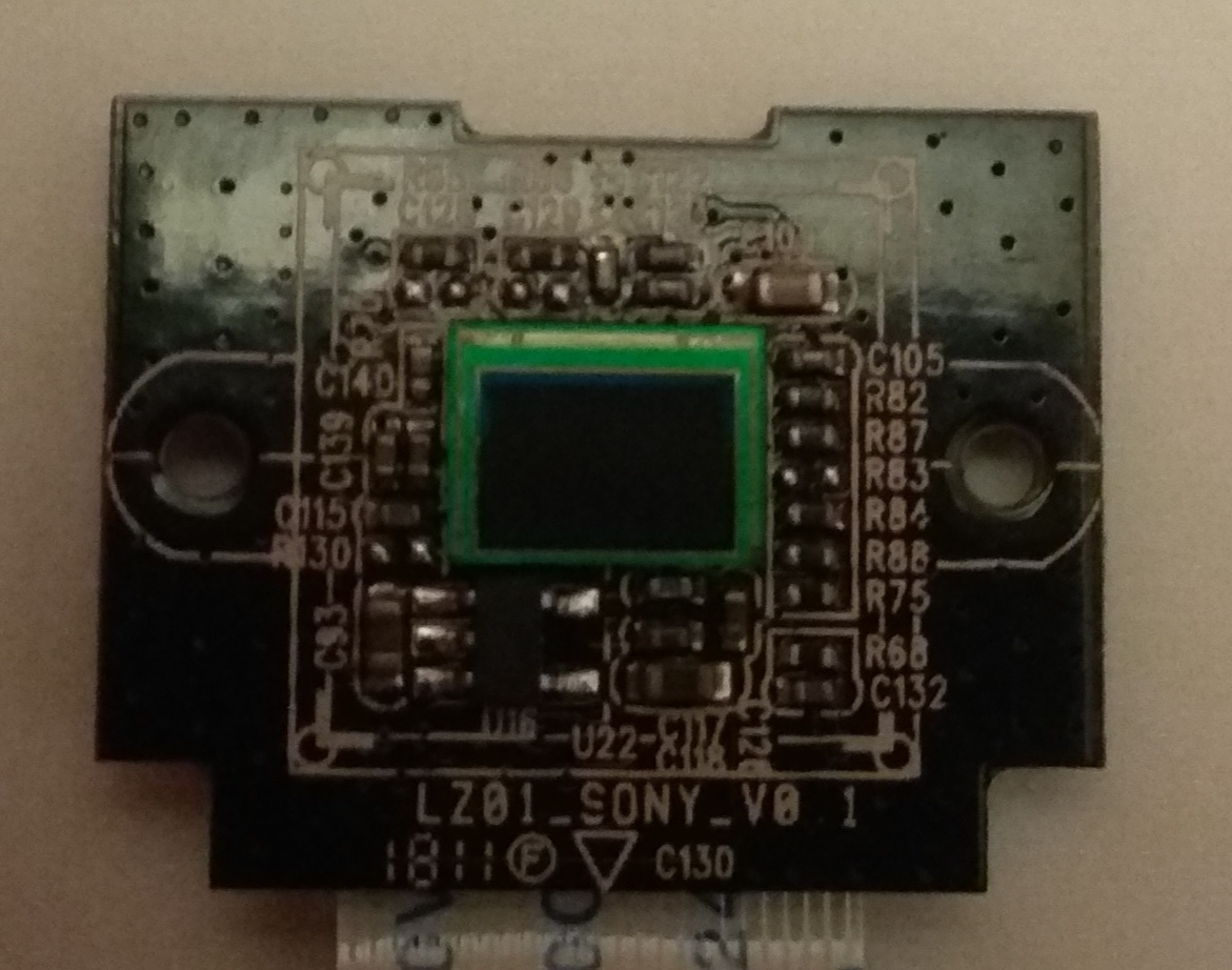

  16. The config file from A1T firmware(JOOYFACTA1T20180608) is very different from the previus.You can see to the file
    almost everything but i haven't tried yet to change them and see how dvr react
    Date_Imprint
    Date_Format
    WiFiOnOff
    TIMELAPSE_REC_FRAME( i believe this is for parking guard the frames that you want to rec per second)
