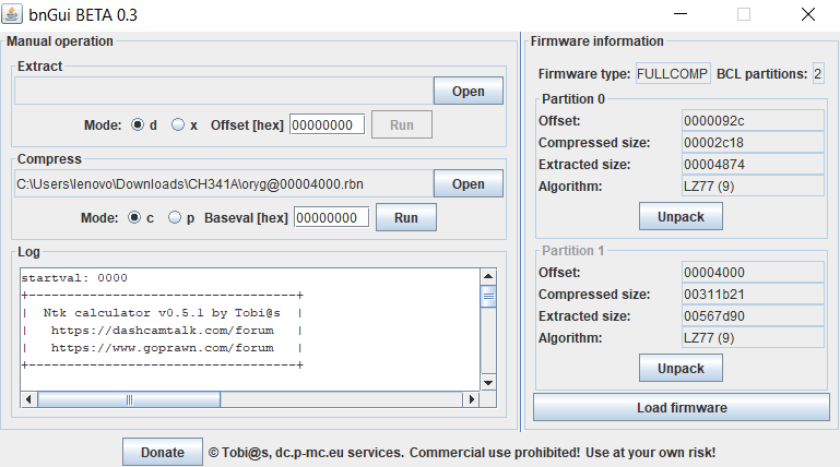

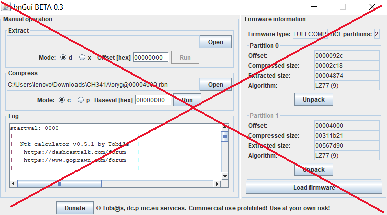

  2. Ok, but I have 2 BCL partitions in my firmware not 1...flashing your firmware with 36bitrate will kill it ?
  3. There's one section, it will not kill.
    And if he kills, there's a full firmware.
    At me does not kill !! :)
  4. [QUOTE = "valeri07, post: 136538, członek: 11881"] Jest jedna sekcja, nie zabije.
    A jeśli zabije, jest pełne oprogramowanie układowe.
    U mnie nie zabija !! :)[/ QUOTE]
    S I must flash with SD Card- I can't with a programmer ? I made a firmware from my original with 11600bitrate (x2) and BnGUI made firmware with 1 BCL ...it's strange that it can't made full compressed firmware from 2 partitions.
      28,6 КБ
      879
  5. This is not the tool
    And you do not need it.
    From the full firmware, do the firmware is wrong.
    And why do you need it, my much better!

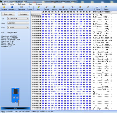

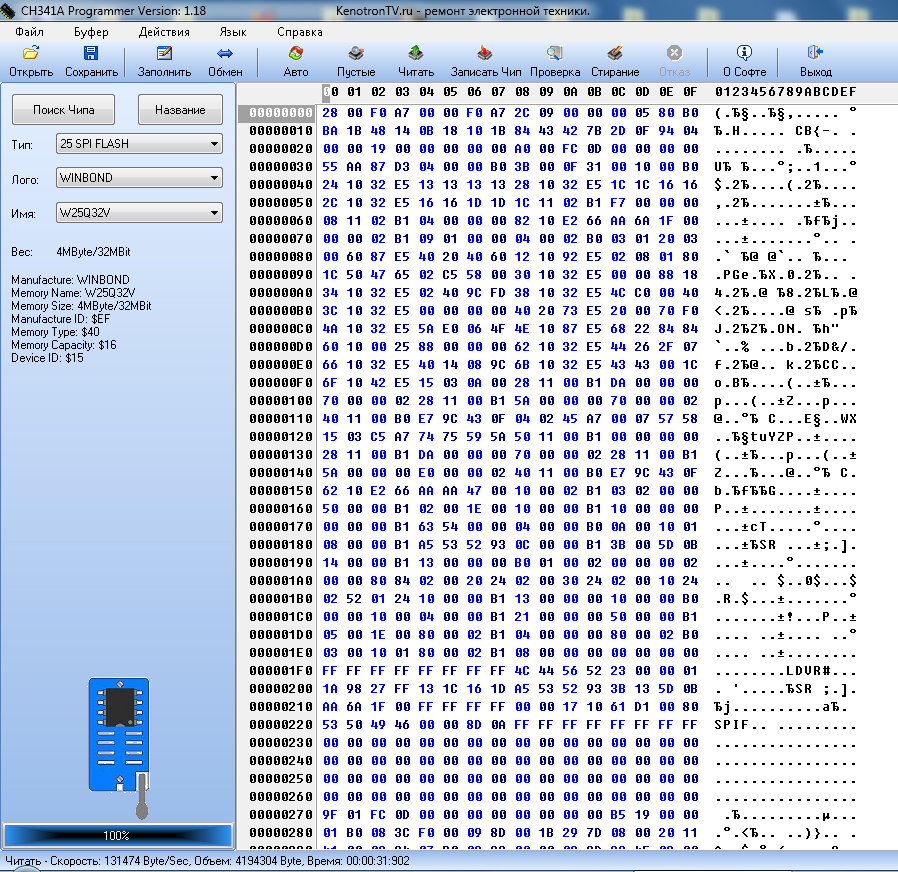

  6. Now I see that programmer detect chip3205D but on chip is 3206E....strange

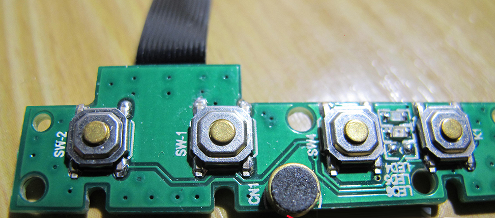

  7. OK,Your firmware is working but...I have only power ON/OFF button and Wifi and 3 is not active and on Car screen I can't change any options....and night mode are very darkwith more "orange skin" then in my.....quality is awsome :) Now I am able to see car plates on my firmware and my xenon light I saw only plates full of white color :) Could You please tell that in Your firmware there is option to change saturation ? on my firmware was....maybe You want to cook my firmware with 36mb bitrate and whole buttons will be active :)?

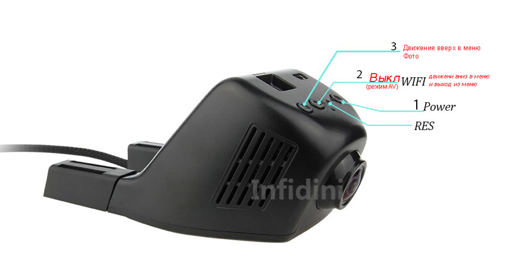

  9. I flashed 1 with 36MB bitrate...I have power on left, now Wifi turn ON/Off on center, next the third is not working and 4 RESET have not checked yet...now I cant turn OFF sound and change any options.
    Oh and LEDs dont work at all

  10. You need to flash CH341A - my full firmware(12345.BIN).
    I'll take a look at yours, my own, but it's bad.

  14. Until my full_firmware(12345.BIN) is stitched it's hard to say why !!
  15. Is it possible to flash fullfirmware with sd card ? I dont wont to desolder chip again because I dont have much time this week.
  16. no, only through CH341A
    try it while yours, I did to you with a bitrate of 20 under the TimaCam

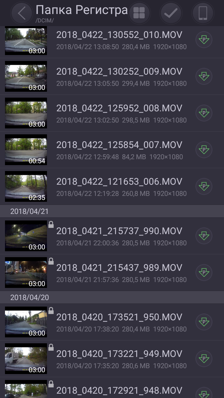

  19. Датчик удара сработал или ты сам кнопочку нажал.
