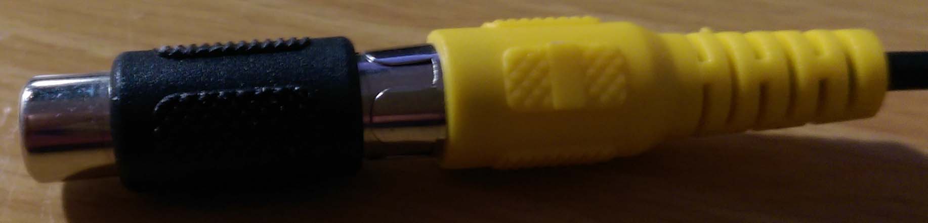

    At me too AV short, I through its adapter have extended it.
    It does not matter, they are equal.

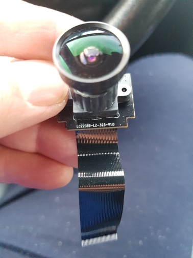

    And there are photos of all the boards of your dvr?
    There are doubts, very cheap.
    Here's mine, ~ twice as expensive with the same gland !!

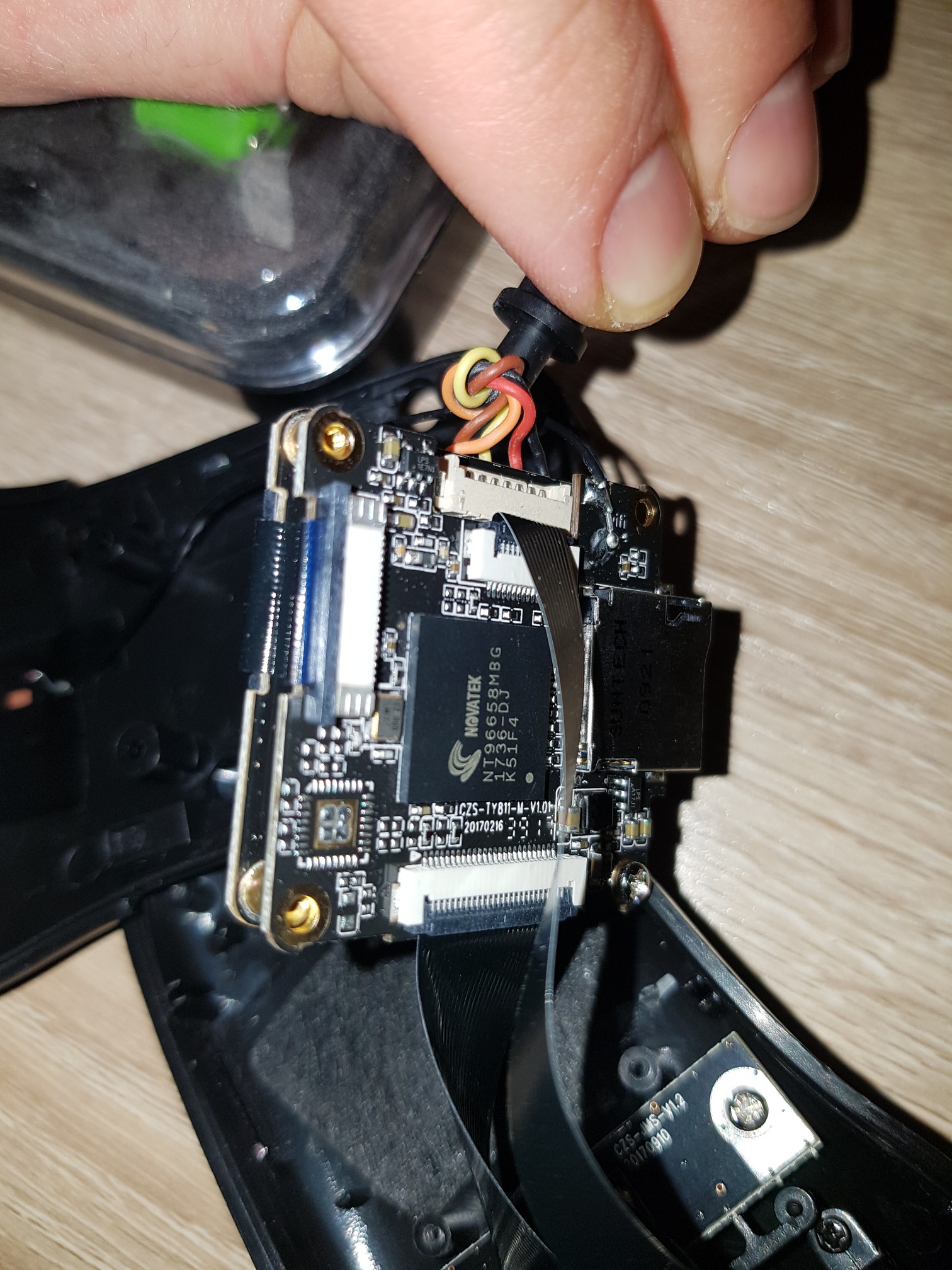

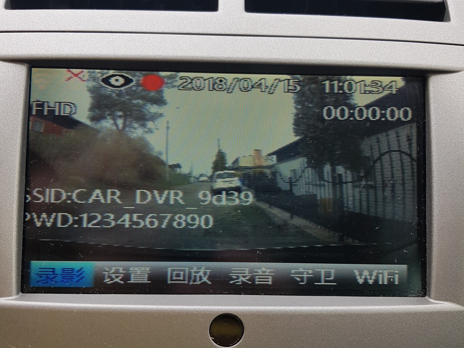

  11. I have connected to car....white logo with black text welcome and green one with white text goodbye.... and everything is in chinese....why without wifi bitrate is so big ? Wifi stoles transfer ? Ok please aend me this 2 firmwares to my email anikocio@gmail.com
  12. OK!
  13. I will give it a try, BIG thanks !

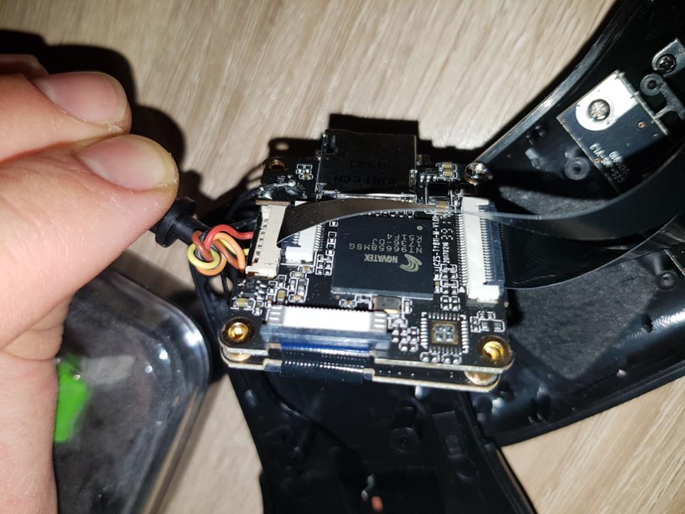

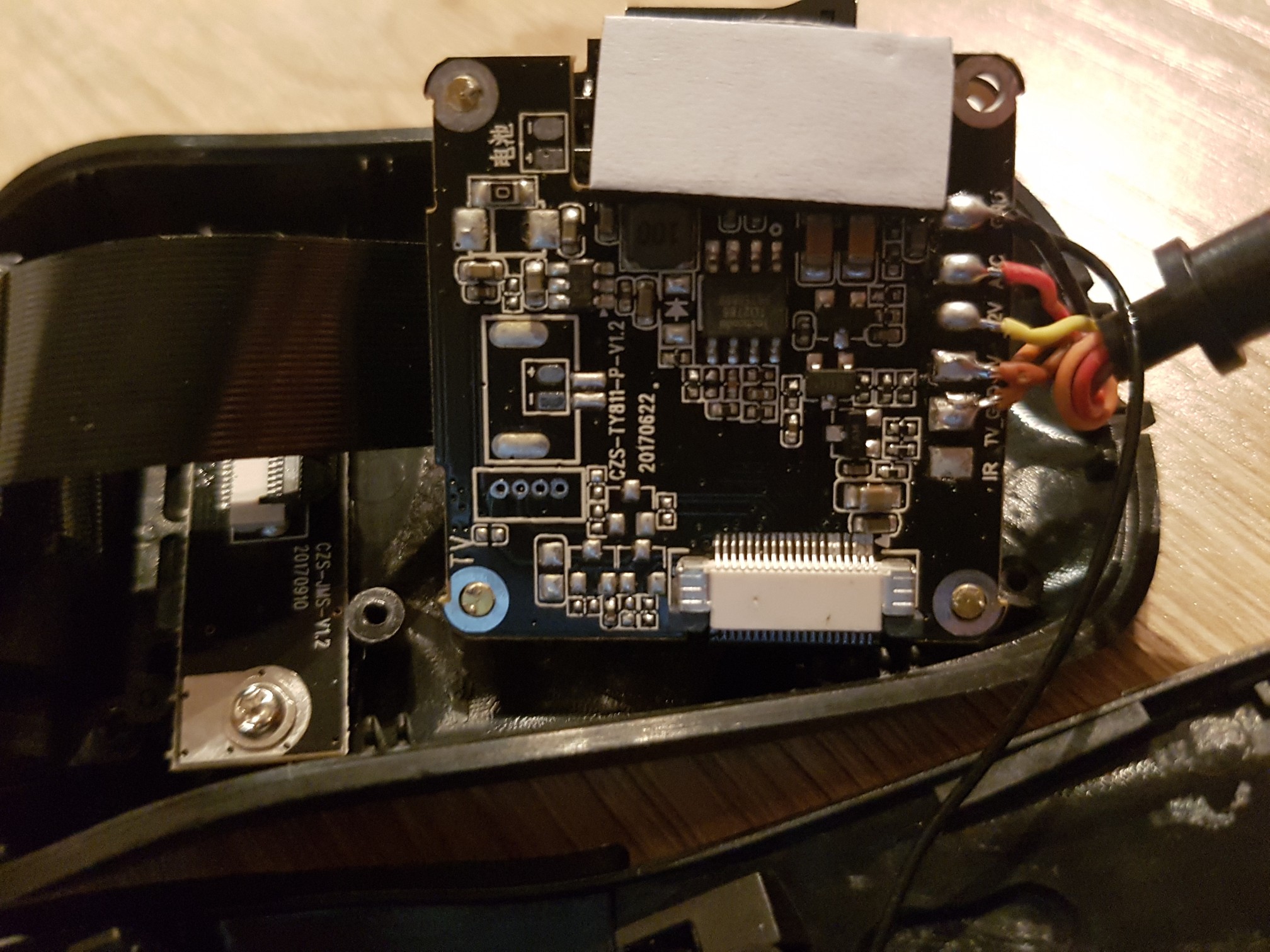

  14. Check the chipset, I suspect there is a small volume, does not fit the firmware.
    If the ROM is different, you need to replace it with this (here you need a specialist consultation), like me, to flash a full firmware - a programmer !!
    Otherwise brick!
    Проверьте чипсет, я подозреваю там объём маленький, не влезет прошивка.
    Если ПЗУ другой, нужно заменить на такой(тут нужна консультация специалиста), как у меня, прошить фулл прошивкой - программатором!!
    Иначе кирпич!!!
  15. So if I will brick my dvr there is a chance to recover by changing this chip and flash with programmer on USB ?
  16. Yes - CH341A
    If you can copy your full firmware via USB - CH341A !!
    And then sew!
    Если можете скопировать свою фулл прошивку через USB - CH341A!!
    А потом шейте!!!!

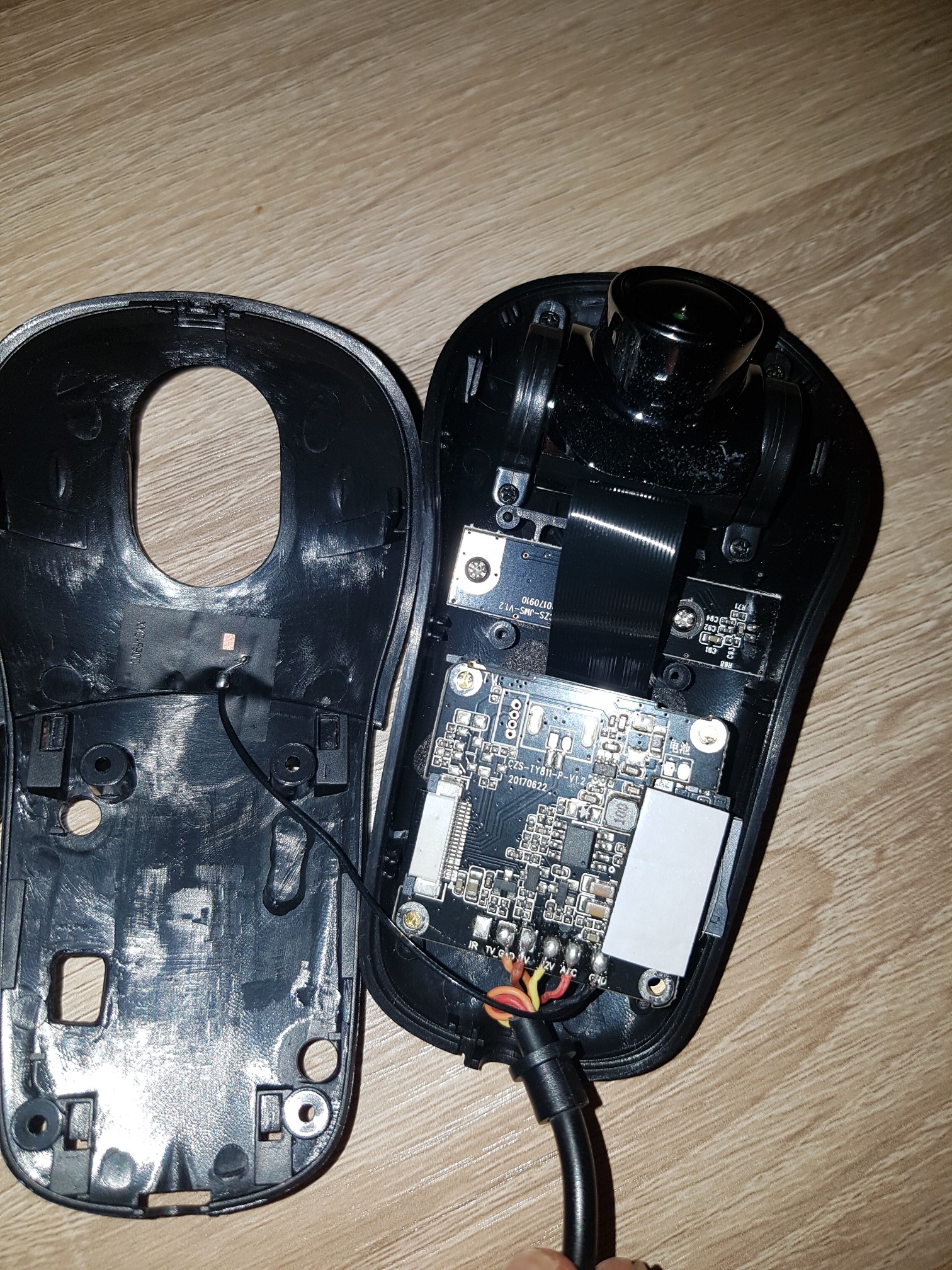

  17. Ok I bought programmer on USB ch341a and I will disassembly dvr and make a full copy of a chip....I worked 8 years in GSM service so I have necessery equipment. I will ask here for a help if I will have trouble with firmware downloading. I will have programmer on tuesday. Thanks for a tip.
  18. Fine, then show this firmware.:rolleyes:
    Of course we will help, than we can !!! :D

  20. Judging by the full firmware - it !!
    You can safely sew any that I threw you.
    By the Wifi bitrate 36 does not work, only 20 !!
    Here is my full firmware, you can first flash it on USB !!
    https://drive.google.com/open?id=1IRS7H9oCOQZ0Hl_kxpyJUafrCeTer9pa
